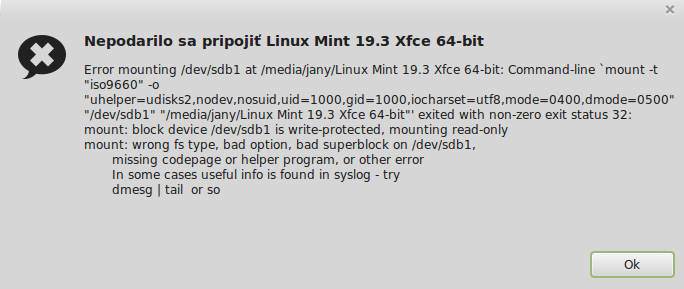

Teraz som na USB nahral linux mint 19.3 a ked som ho chcel znova naformatovat, tak po strceni do PC som dostal tuto tabulku
vystup dmesg
[  489.382724] Info fld=0x0
[  489.382727] sd 2:0:0:0: [sdb]
[  489.382731] Add. Sense: Write protected
[  489.382735] sd 2:0:0:0: [sdb] CDB:
[  489.382737] Write(10): 2a 00 00 00 00 00 00 00 08 00
[  489.382748] blk_update_request: 58 callbacks suppressed
[  489.382751] end_request: critical target error, dev sdb, sector 0
[  489.382756] quiet_error: 2019 callbacks suppressed
[  489.382759] Buffer I/O error on device sdb, logical block 0
[  489.382762] lost page write due to I/O error on sdb

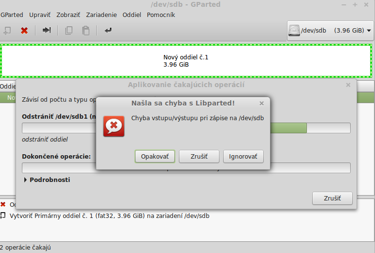

Ked chcem formatovat cez gparted dopadnem takto.
Dalsie subory pridam do dalsieho prispevku, lebo tu je obmedzenie na 3.

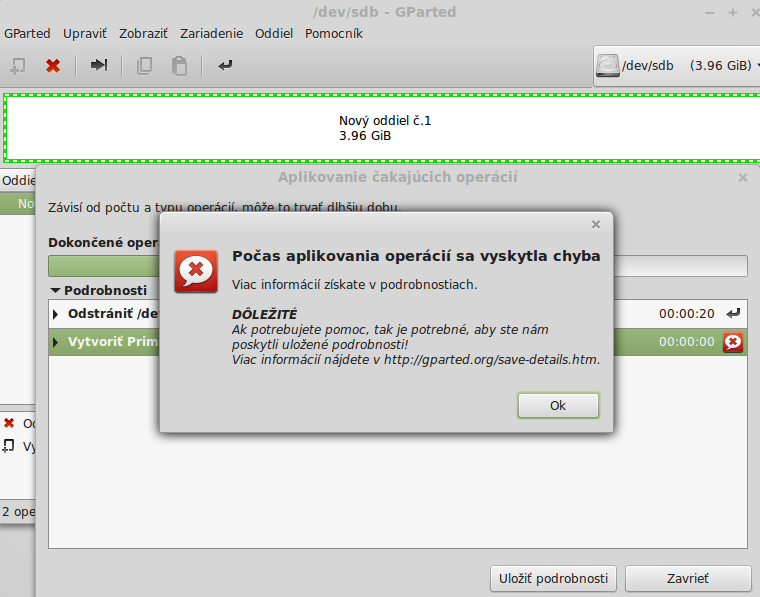

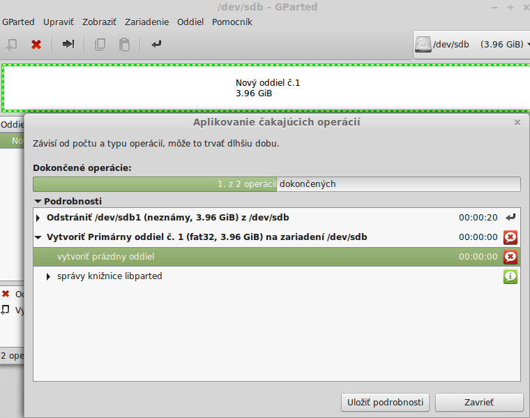

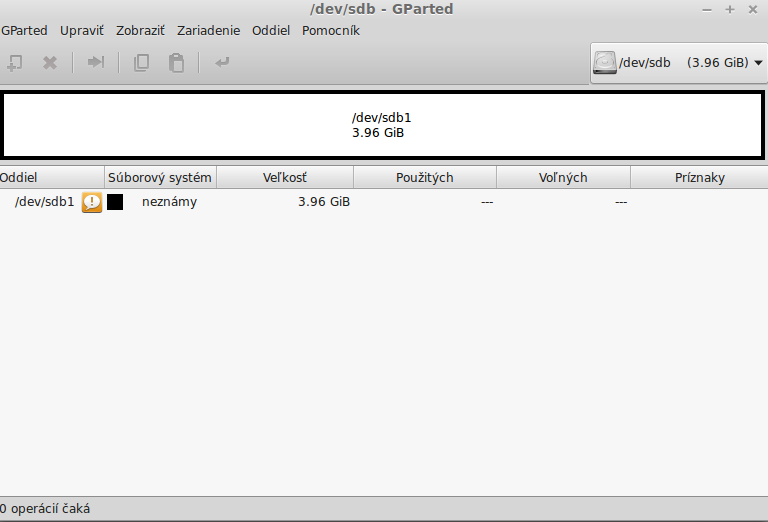

dalsie obrazky.
Pokusal som sa robit to aj cez prikazovy riadok (fdisk), ale dopadol som podobne. Gparted robi zrejme to iste, a le cez gui
