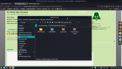

...do mate to vies dostat???...tu pise,ze bol testovany na cinnamone...
https://www.pling.com/s/Mate/p/1419843
:idea: :idea: :idea: :mrgreen: :roll: :oops:
takto vyzera s temou infinity... :geek: :geek: :geek:
Naposledy upravil(a) alojz dne 08 led 2022, 08:24, celkem upraveno 1 x.
