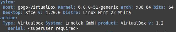

Nainstaloval som to pekne po jenom baliku co su v adresari src na virtualnom minte 22 Wilma podla https://docs.xfce.org/xfce/building.
zavislosti https://docs.xfce.org/xfce/building#xfc ... _explained
kompilacia https://docs.xfce.org/xfce/building#bui ... e_packages
