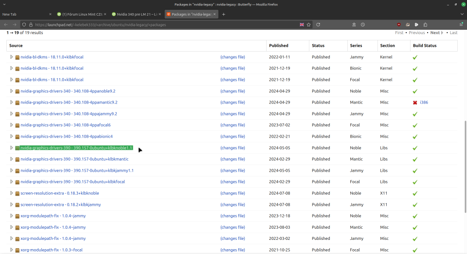

Akurat na tej stranke na launchpade https://launchpad.net/~kelebek333/+arch ... /+packages
je potrebne kliknut na toto - nvidia-graphics-drivers-390 - 390.157-0ubuntu+klbknoble1.1
A tam nizsie by som vybral, stiahol a manualne nainstaloval tieto baliky:
  • libnvidia-compute-390_390.157-0ubuntu+klbknoble1.1_amd64.deb (20.0 MiB)
    libnvidia-decode-390_390.157-0ubuntu+klbknoble1.1_amd64.deb (1.2 MiB)
    libnvidia-encode-390_390.157-0ubuntu+klbknoble1.1_amd64.deb (56.1 KiB)
    libnvidia-fbc1-390_390.157-0ubuntu+klbknoble1.1_amd64.deb (43.8 KiB)
    libnvidia-gl-390_390.157-0ubuntu+klbknoble1.1_amd64.deb (15.2 MiB)
    nvidia-compute-utils-390_390.157-0ubuntu+klbknoble1.1_amd64.deb (72.1 KiB)
    nvidia-dkms-390_390.157-0ubuntu+klbknoble1.1_amd64.deb (15.8 KiB)
    nvidia-driver-390_390.157-0ubuntu+klbknoble1.1_amd64.deb (388.7 KiB)
    nvidia-kernel-common-390_390.157-0ubuntu+klbknoble1.1_amd64.deb (11.1 KiB)
    nvidia-kernel-source-390_390.157-0ubuntu+klbknoble1.1_amd64.deb (9.5 MiB)
    nvidia-utils-390_390.157-0ubuntu+klbknoble1.1_amd64.deb (341.3 KiB)
    xserver-xorg-video-nvidia-390_390.157-0ubuntu+klbknoble1.1_amd64.deb (1.7 MiB)
Ak si pouzival linuxove systemy, tak by si to mal zvladnut.
